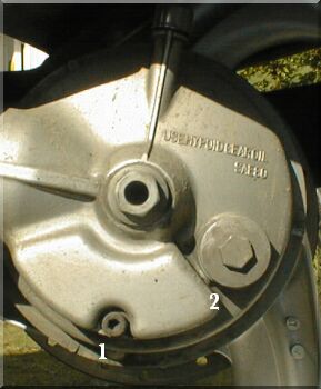

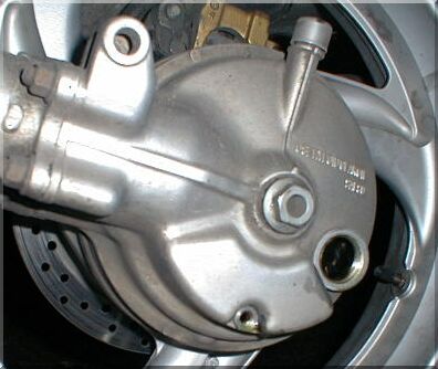

Put the bike on it's sisdestand. Remove the drain plug filler cap taking care not to loose the washer on the drain plug.
Inspect the aluminum washer on the drain plug, you might want to get a new one every other time.
Drain for as long as it takes.

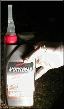

Bring out your best transmission oil.

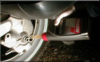

Tighten the drain plug - 12 Nm torque. Put the bike on its centerstand. Fill up.

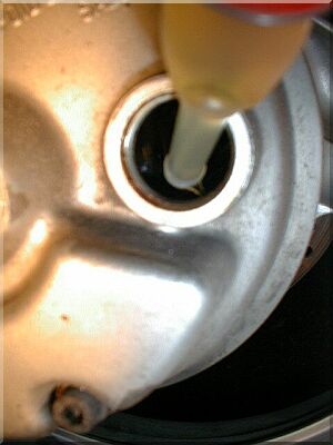

Fill up - let it settle and fill up again until the oil is level with the filler
hole. If you fill too much it will spill from the filler hole. Wipe off the
filler cap sealing and put it back. Take care not to overtighten.
