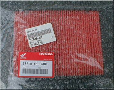

Step one : buy a new airfilter
The first thing you need to do is to lay your moist hands on a new
arfilter. Here is a picture of the tag on the package i bougt from my local
HPP ( Honda Parts Pusher ) supposed to contain a new airfilter for my Deauville,
which it actually did.

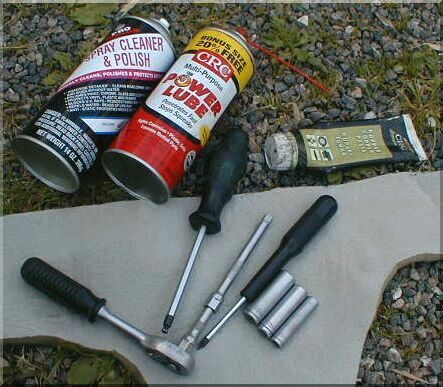

Tools needed for this job
I never use crap tools when fiddling with my Deauville, and i always keep my aerosol collection at hand,
to clean and lubricate all the parts i get in contact with, while i am at it. I also use copper paste on nut and bolt
threads when assembling, to avois seizure.
The tools needed for this job is 8mm, 10mm & 12mm socket wreches with extensioner and rachet.
A 5 mm Unbraco hex key (left screwdriver lookalike). I preffer to use the screwdriver type to avoid damage
to the surrounding fairing when tightening /untightening.
And finally a screwdriver, star type (or whatchummacallit).
In addition i used some clean rags, for cleaning the grit, grime and dirt
off the dismatled parts, and the ignition key, to unlock the seat, allowing it
to be removed.

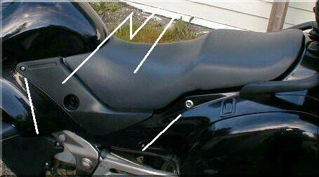

Seat & sidepanels : removal of the gesitz.
Use ignition key to unlock seat. Lift rear end out of the lock, pull seat
off backwards. Unscrew hex bolt on left sidepanel and remove. Remove right
sidepanel ( no scewing involved ).

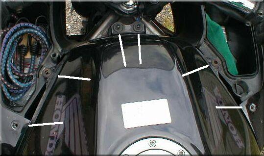

Tank front area : get rid of these 4 bolts and 2 nuts.
Two 10 (or 8)mm nuts, two star screws and two unbraco hex screws.

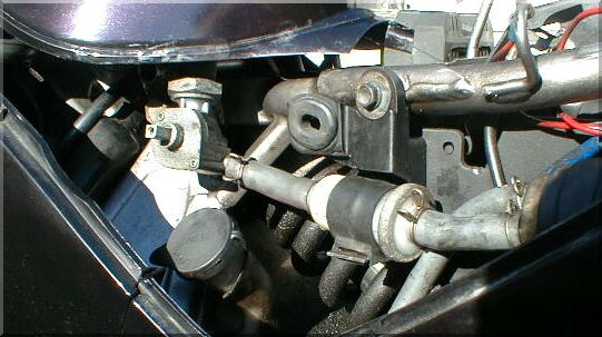

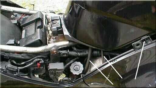

Tank rear left : fuel cock & tank bolt
Pull the fairing plastic cock out of it's rubber vulva in the tank.
Close and prefferably remove the fuel cock handle. This involves a
screwdriver to unscrew the screw in center of the cock handle.
Pull off the main fuel supply tube from the fuelcock. This causes some fuel
spill.
Remove the 12mm bolt from the rear end of the tank.

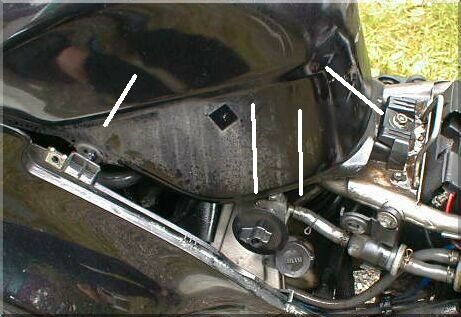

Tank rear right : fuel overfill & breather tube

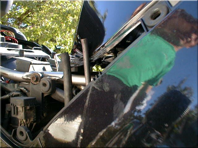

Remove these two rubber tubes by pulling them downwards. Pull fairing
plastick blob out of tank rubber mount. Make a bed for the tank. You do not
want to damage the paintwork or the fuelcock by letting it rest on your
concrete shed floor. I use my lawn as bed and a piece of wood as riser, to
keep the fuelcock off ground. Lift off the tank gently. Avoid damaging the
fairing. Place tank in bed.

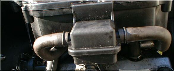

Airbox rear : pressurising tubes (or whatever their name is)
Pull off these two rubber tubes by loosening the steel clamp and thereafter
pulling the tube off. Help them move, if nececcary, with a flat screwdriver

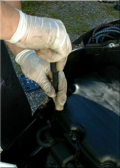

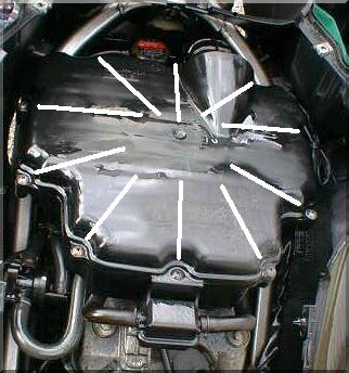

Airbox lid : 10 lid screws
The ten screws that holds the lid of the lunchbox in place are situated as
indicated. Remove in random order.

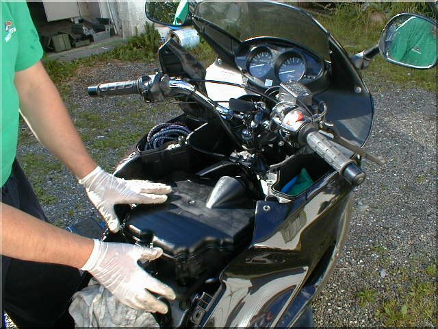

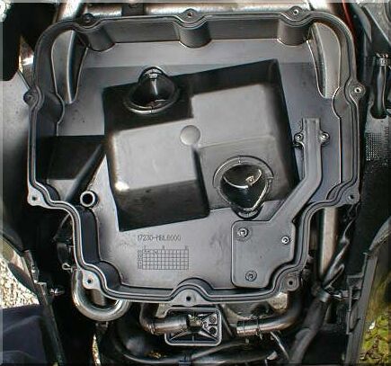

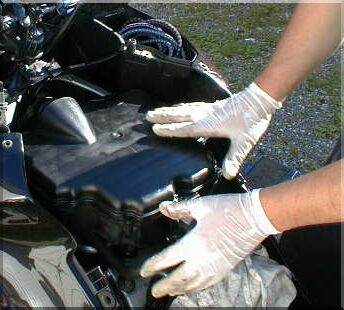

The moment of truth : 9.. 8.. 7.. 6.. 5.. 4.. 3.. 2.. 1.. 0 and we have lift off
Be sure to wear white gloves on this important occasion.

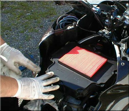

When it all looks clean you are ready to drop in the new filter
Do not loose any tools, rags, nuts, dirt or any other kind of object into the two air intakes.

In goes the new filter, no more heavy breething from this Deauville.
